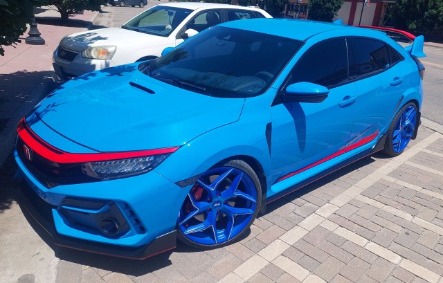

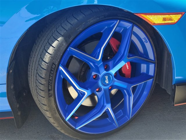

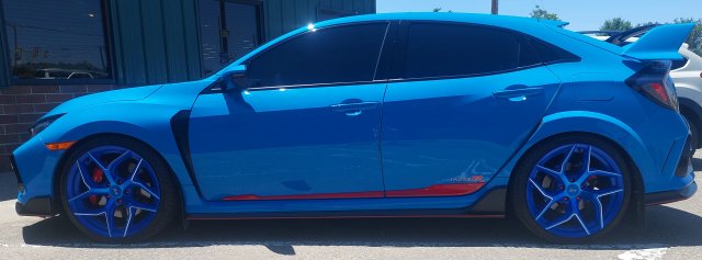

2021 Type R - recently changed out wheels n tires (why go down to 18" dia, will have ODD Looking space in fender wells - TO ME)
my following wheel purchase
pushed FACE OF my Tire/Wheel outward by 1" - they are now flush with fenders (some people buy Spacers to do this - mine came about due to Wheels i selected)
STOCK Wheels are 20 x 8.5
Niche Torsion Blue 20x9 - 35mm offset - 5/120 bolt pattern required - 35 lbs each - plus 4 Concentric Hub Space Rings (to align so required optional Lug Nuts SNUG UP in alignment) RED 14x1.5 lug nuts (20 required)
Michelin Pilot AS-4 tires (web pages recommend these as Top Pick) 245/30/20
SHOP AROUND - often buy all from One Quality TIRE STORE installer - tell them you are getting quotes (get BEST Price)
